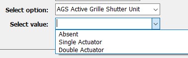

  • Last question: In AlfaOBD V 2.3.6.0 there is no enable option. Is single actuator correct? Thank you for your patience.
    Do you have an older Version of AlfaOBD?
