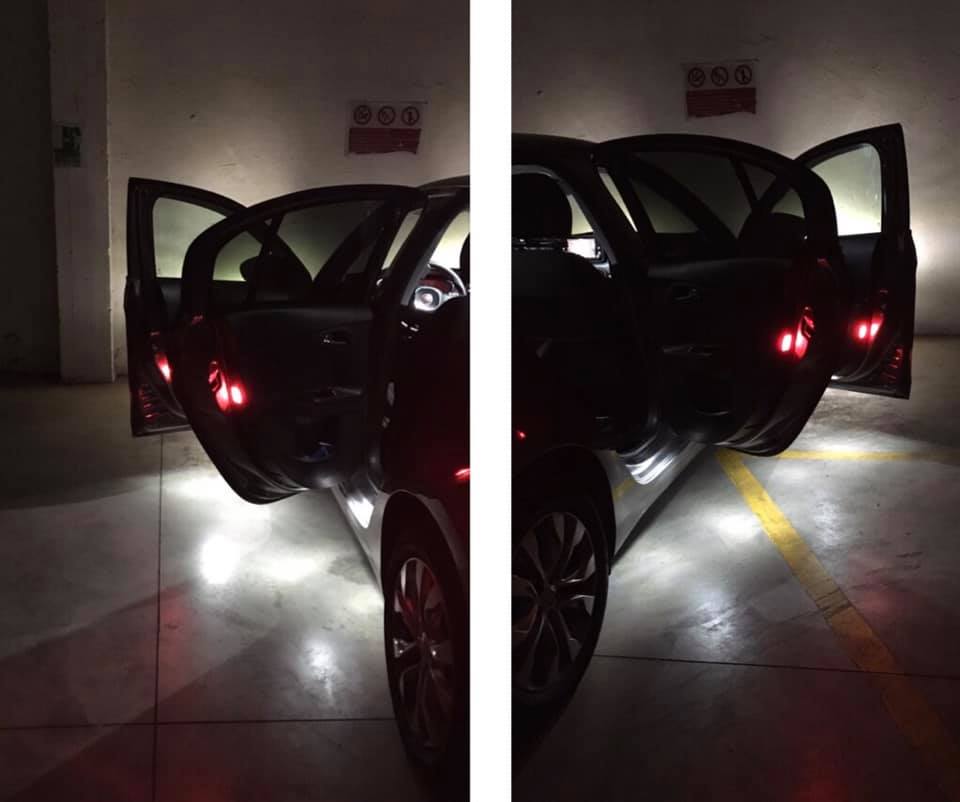

Warning door lights
  • What we want to need:
    4 door lights, 4 magnetic switches (NO - normally open), pins for door connectors.
    lights
    switches
    pins
    Connecting lights and switches is simple, I won't draw that. The power supply is via the new pins in the door, it is connected from the anti-fire circuit, board computer, connector E, pin 9. If you leave the door open for more than 15 minutes, the lights will turn off automatically. If you close the door and leave it open again, the lights will come back on for 15 min...
    schematic:
    Fiat TIPO SW, 2018, 1.6 mJet, 88kw, DPF, A6 DDCT
