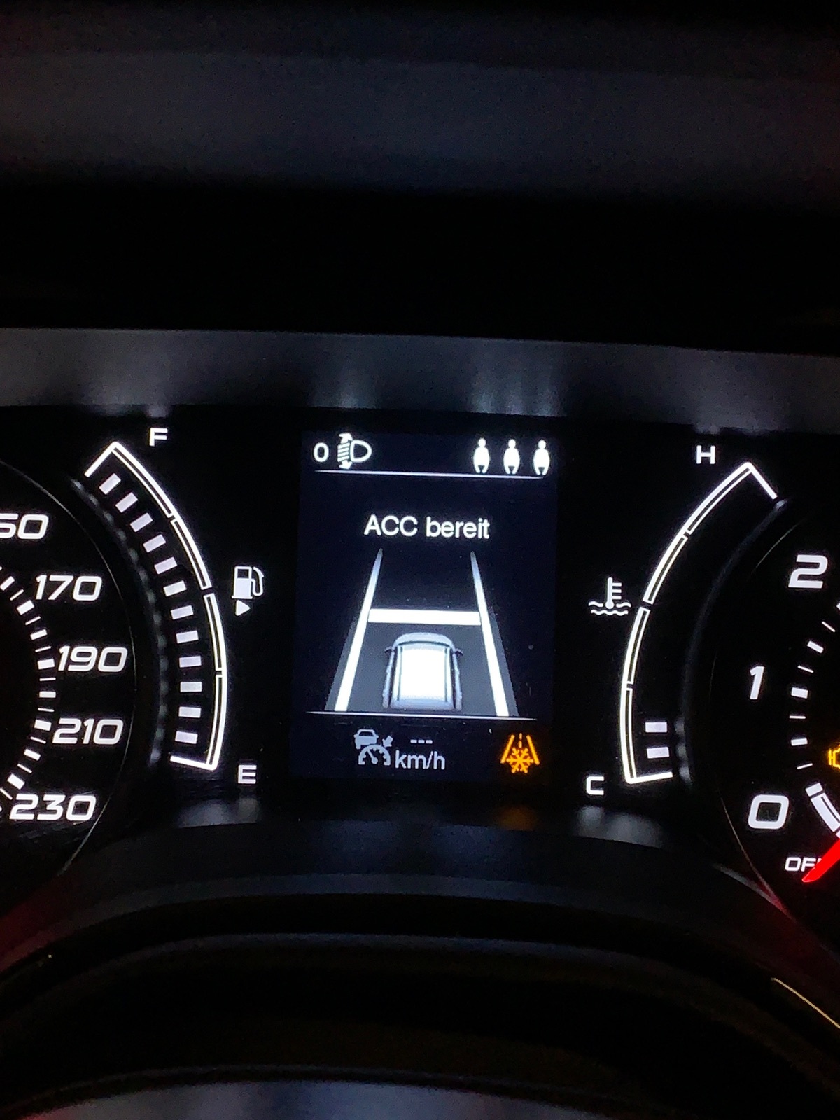

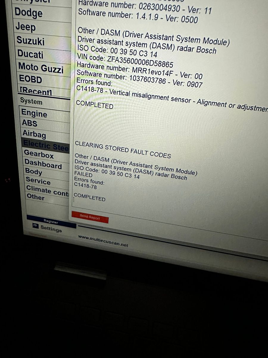

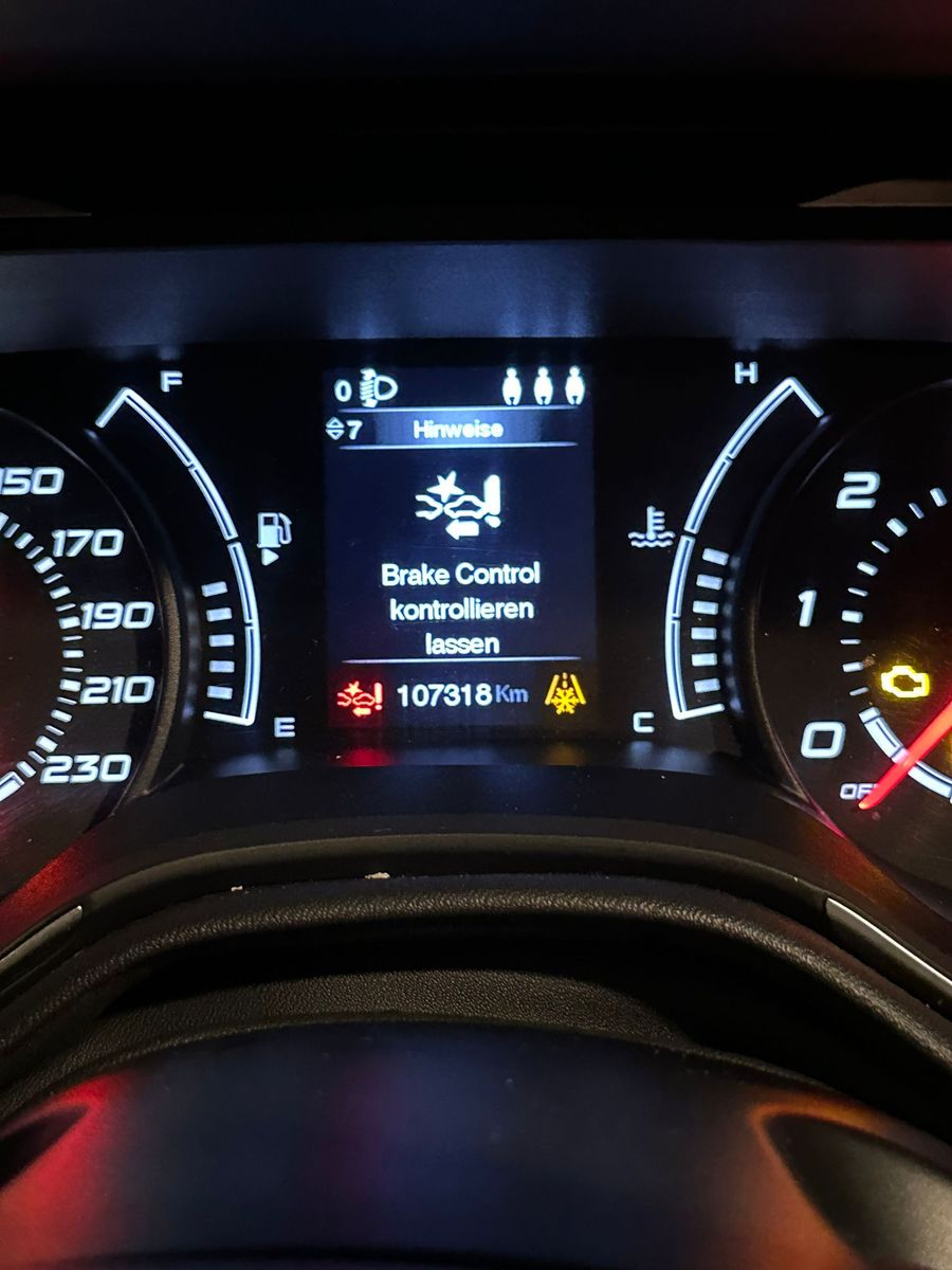

  • Who wrote you to expand the radar? Nobody wrote that the radar is broken. You are doing things that no one has written here!
    How do you get the idea that the radar is broken due to Carplay activation. You don't understand the function of the proxy file at all! Because then you would have known that you cannot destroy any components on the vehicle! This file contains the vehicle configuration. You cannot simply copy this file from one vehicle to another!
    It's too late now. You can't align the radar, you have to go to the workshop now!

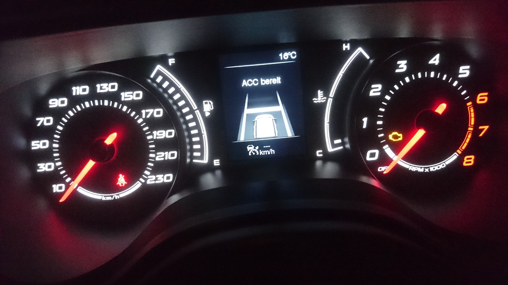

    I reinstalled the original proxy too, but that idiot's acc is not working

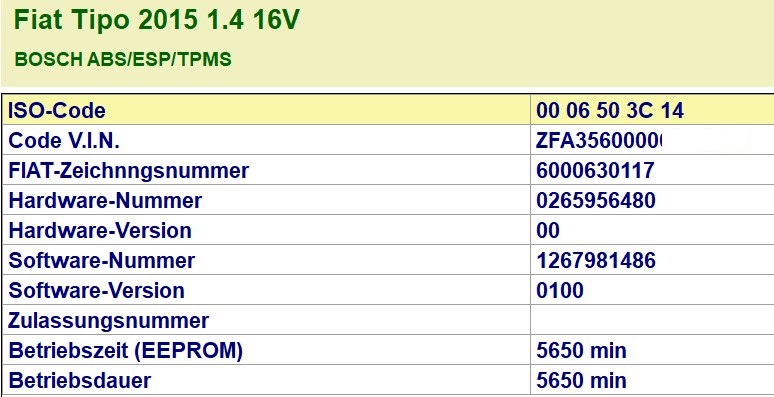

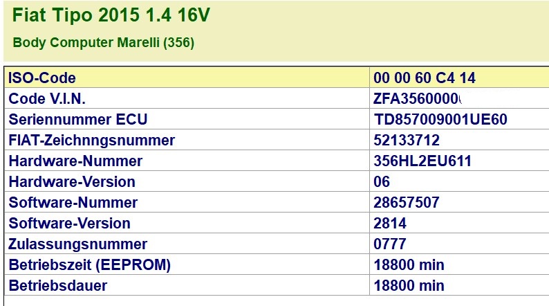

  • Ich kenne den ursprünglichen Proxy, ich habe ihn nicht gespeichert und diesen verwendet 33 36 33 35 36 30 31 30 35 36 33 4F 55 54 50 55 54 44 4A 49 54 20 16 06 08 4F 04 00 05 10 00 00 00 00 00 00 00 00 00 00 00 4F 04 00 05 10 00 00 00 00 00 00 00 00 00 00 00 53 F9 05 02 A4 15 07 8D D0 29 07 07 42 10 00 03 A3 28 04 82 01 35 63 14 00 4F 03 34 01 83 08 00 21 00 03 00 A0 00 00 00 00 00 10 81 00 25 01 5A 00 07 04 B5 00 4E 00 01 A1 10 00 40 00 01 00 C7 00 D5 00 00 00 00 49 00 05 14 70 62 00 00 01 01 00 80 70 00 01 29 C0 00 80 00 05 00 00 00 00 00 00 00 00 01 00 00 01 00 00 00 00 00 00 00 00 00 00 00 00 00 00 00 00 00 00 00 00 00 00 00 00 00 00 00 00 00 00 00 00 00 00 00 00 00 00 00 00 00 00 00 00 00 00 00 00 00 00 00 00 00 00 00 00 00 00 00 00 00 00 00 00 00 00 00 00 00 00 00 00 00 00 80
    sorry, here you write, you didn't save the proxy and use this one. You need the proxy for this car, not a proxy of the same equipment, it must be the original proxy for the car when delivered. Then Carplay may no longer work and then the ACC will also work if it was originally in it.
    But as I said, the radar will no longer work properly anyway and has to be calibrated by a workshop. Once again: no hardware of the vehicle is destroyed during a proxy alignment.
  • sorry, here you write, you didn't save the proxy and use this one. You need the proxy for this car, not a proxy of the same equipment, it must be the original proxy for the car when delivered. Then Carplay may no longer work and then the ACC will also work if it was originally in it.
    Es stimmt, dass ich es nicht gespeichert habe, als ich an der Ausrichtung gearbeitet habe, sondern auf meinem Laptop gefilmt habe, was zu tun war
  • As already mentioned several times, the original proxy configuration has to be restored. If the original configuration was actually recorded using a cell phone, I would check the numbers very closely. 0 and 8, 5 and 4 or 6 are also possible sources of error.
  • This is the original proxy
    33 36 33 35 36 30 32 33 31 35 35 4F 55 54 50 55 54 44 4A 49 54 20 16 07 10 4F 04 00 05 10 00 00 02 00 00 00 00 00 00 00 00 4F 04 00 05 10 00 00 02 00 00 00 00 00 00 00 00 51 F9 05 02 A4 15 07 8D D0 29 02 07 42 10 00 03 A3 28 04 82 01 35 63 14 00 4F 03 34 1B 83 08 00 3F 00 05 00 A0 00 00 00 00 00 10 81 00 25 02 5A 00 07 04 AD 00 4E 00 01 A3 10 00 40 00 01 00 C7 00 D5 00 00 00 00 49 01 01 14 70 62 00 00 00 01 00 80 70 00 01 29 C0 00 80 00 05 00 00 00 00 00 00 00 00 00
